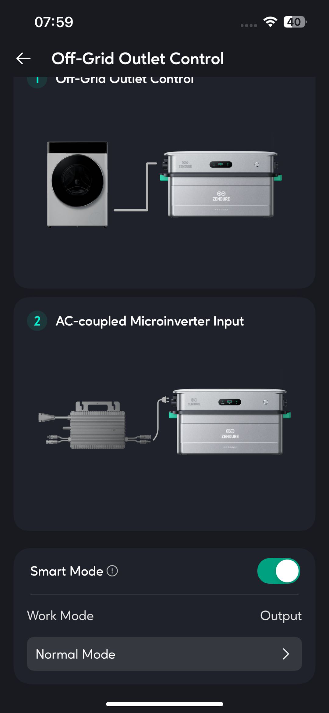

6. How to Use AC Coupling Function for SolarFlow 800 Pro and SolarFlow 2400 AC
Please update to the latest firmware version.
Open the Zendure APP, select the corresponding device, go to the settings interface, select “Off-Grid Outlet Control”, and enable the off-grid outlet.
After enabling the off-grid outlet, if you connect a household load, the device will automatically detect and switch to output mode, and please ensure the mode is set to "Normal Mode". If you connect a micro-inverter to the off-grid outlet as per the user manual, the device will automatically detect and switch to input mode, using AC coupling to supply power to the home, and the HEMS system will automatically record the AC-coupled solar data.
