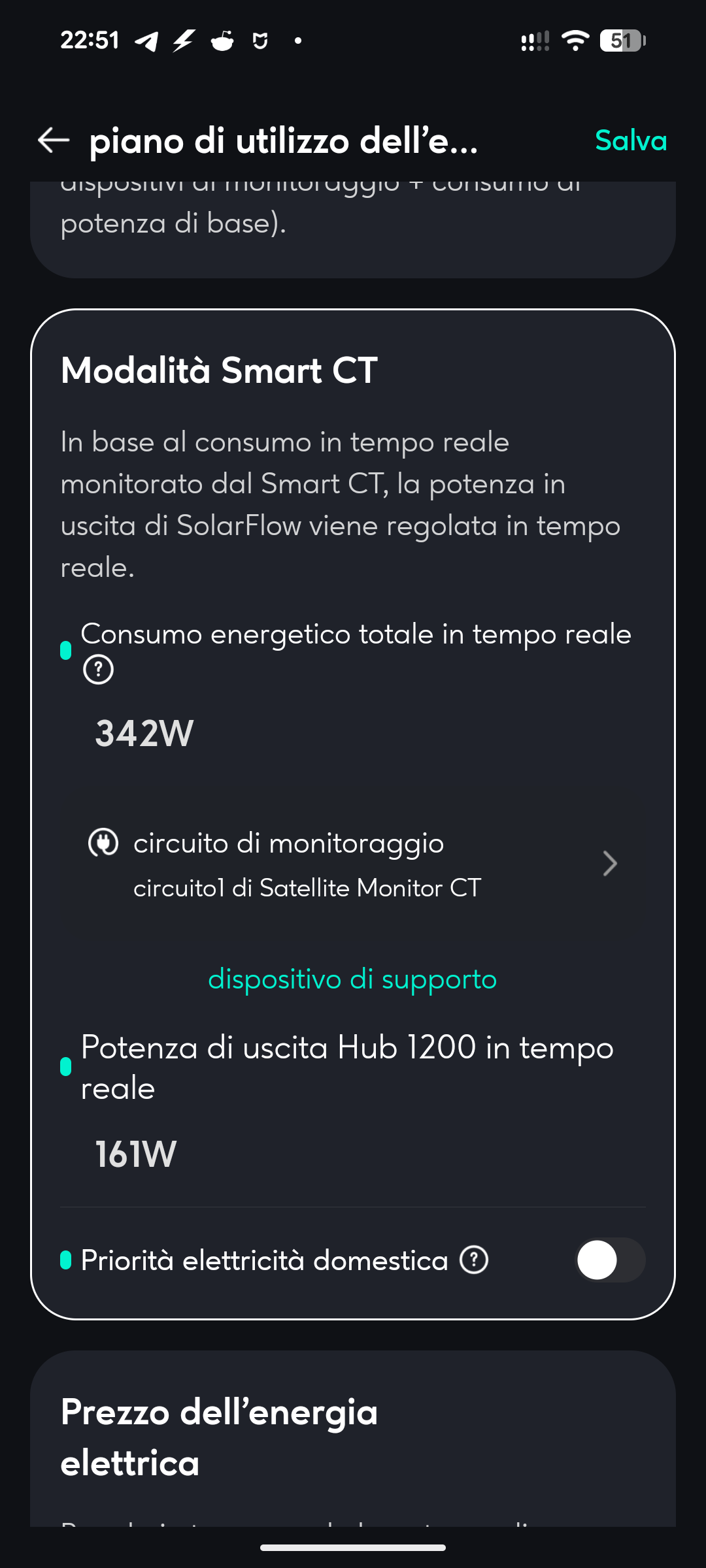

Some days ago, the smart CT mode stopped working and the HUB filled up the batteries to 100%.
I checked that the Zendure CT mono phase was still reading data and that the HUB was able to work in standard mode.
I then tried to change modes and for 30 seconds it seemed tracking again correctly, however it then stopped again, keeping the output power at the last set value.
I have tried rebooting it, changing modes again, but the issue persist.
Here's a screenshot of the problem. I already opened a support ticket but I didn't get a reply yet.
