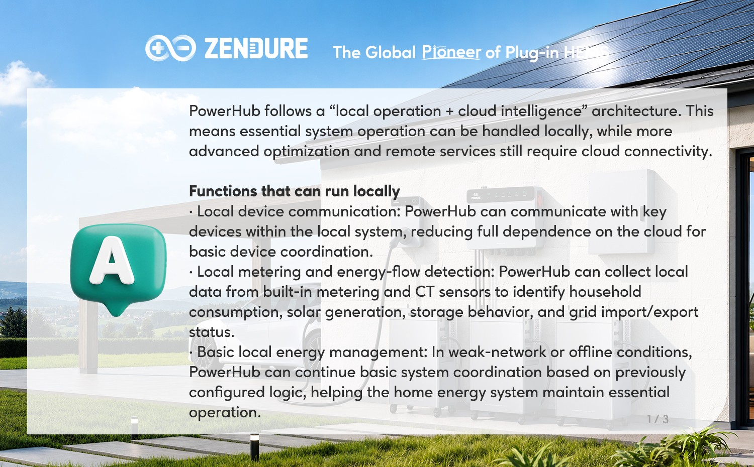

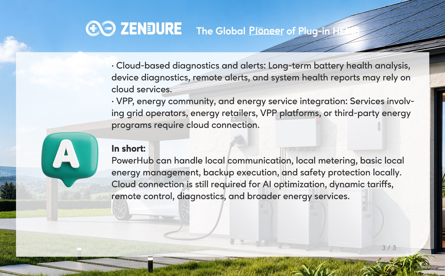

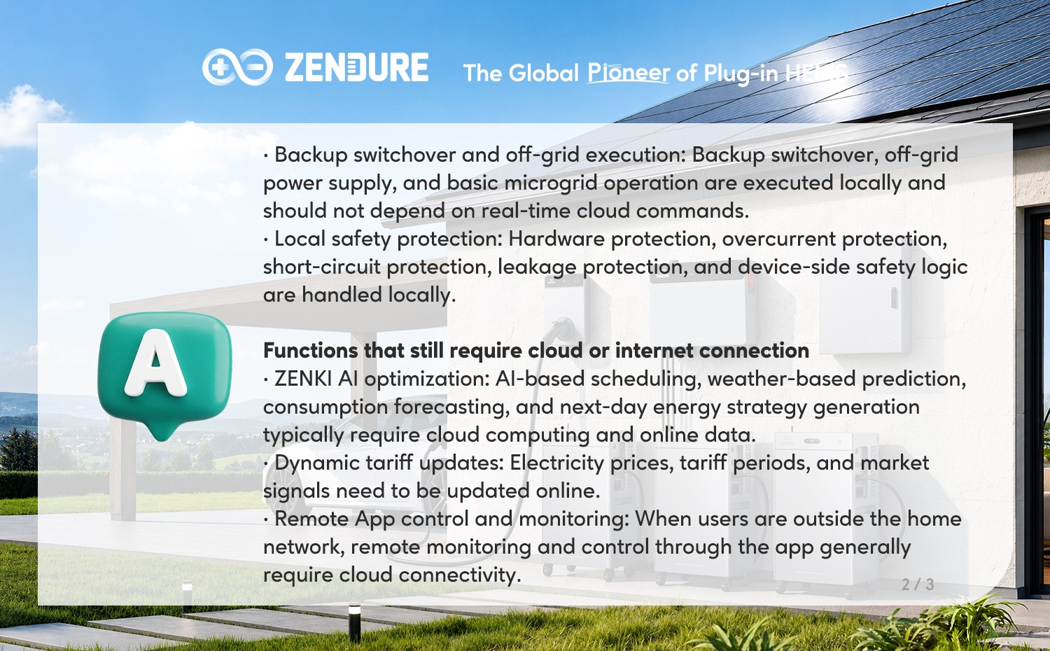

Dear Zendure Users,
We have collected the discussions in the forum regarding the SolarFlow Mix Series, and hope to centrally answer your following questions:

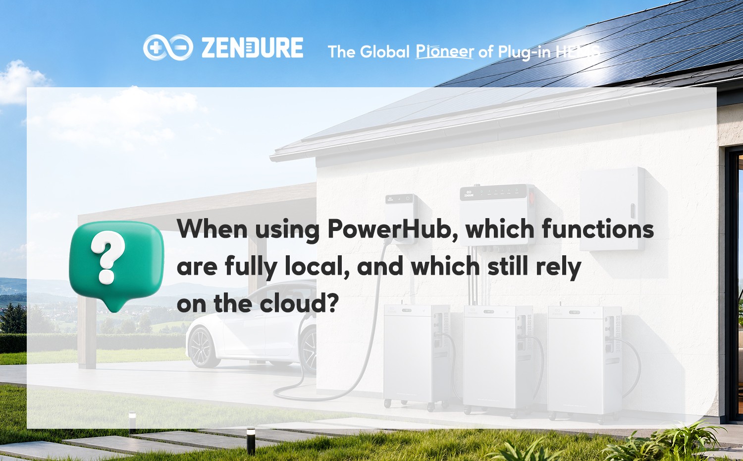

🔹 When using PowerHub, which functions are fully local, and which still rely on the cloud?

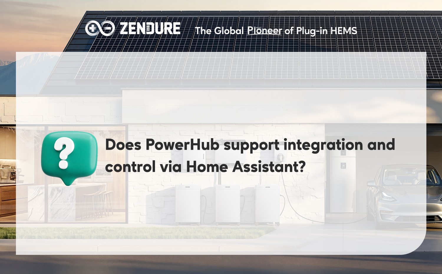

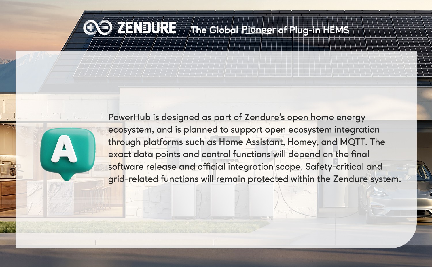

🔹 Does PowerHub support integration and control via Home Assistant?
