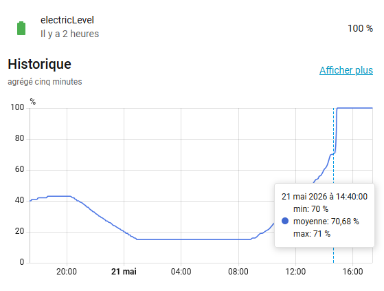

Today we had a sunny day and I saw that the loading speed from the battery was quite slow while being at only 70% capacity. Since I know that the load speed lowers when reaching 100%, I changed manually the max value for the battery from 85% to 100% and it reached 100% in no time (it went from 70% to 72% to 100% basically).

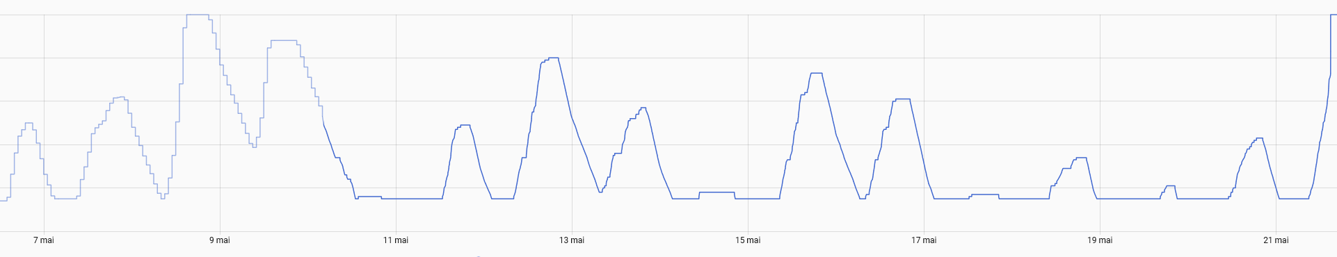

I know that the BMS needs a monthly calibration, but is it normal that it is so bad ? We are talking about a 30% error in less than 2 weeks here...
I checked the load % for each battery and they all went from 72 to 100% in a single minute, so it's clearly the BMS that is hallucinating.
