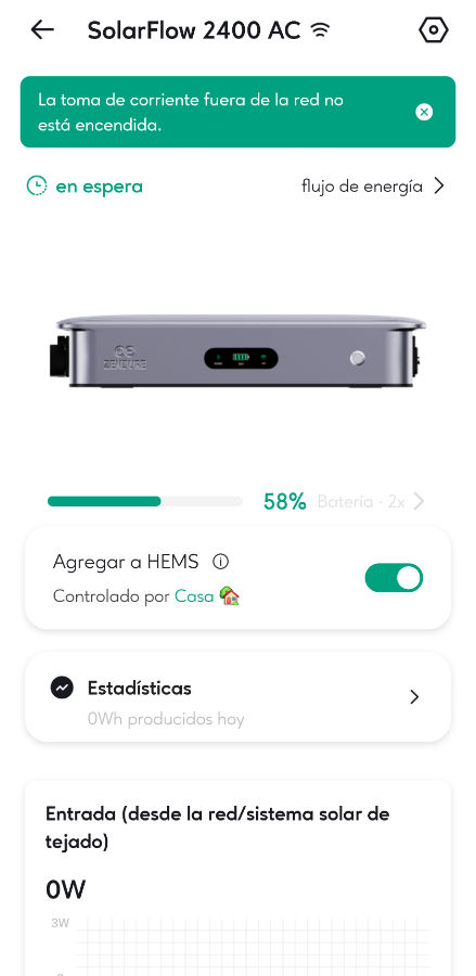

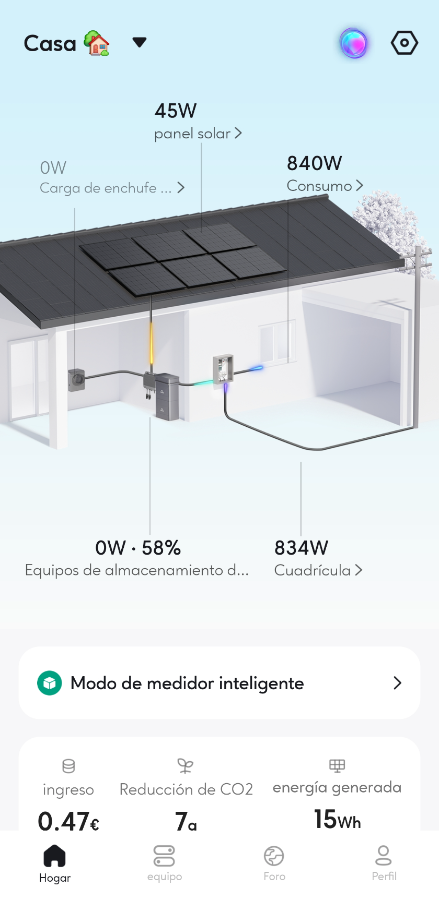

Current behaviour:
The unit stays permanently in "Standby / Waiting" mode
No grid charging - the app shows 0W input from grid, despite the outlet being powered (the app itself warns: "The off-grid outlet is not turned on").
No discharge - the batteries are at 58% (2× AB3000X) but the unit delivers 0W to the home circuit
The power LED blinks green continuously

System context:
SolarFlow 2400 AC (replacement unit)
2× AB3000X batteries
Smart Meter 3CT (Smart Meter mode enabled)

Has anyone managed to get out of this loop?
Could this be a firmware issue or a server-side HEMS configuration problem?
Does anyone know how to get the batteries out of standby mode?
