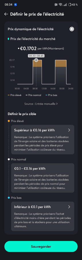

Hello Zendure users,
I’ve noticed a strange behavior with my
Solar flow 2400AC.
When I set my night tariff in the “lowest price” category, the battery systematically charges during the night, regardless of whether the next day is expected to be sunny or not. This results in about 2 to 3 kWh being consumed every night, even when the following day is sunny and the battery does not actually need to charge overnight.
How can I prevent this behavior?
At the moment, I have moved my night tariff to the “normal price” category and set my daytime tariff as “high price.” Will this be enough to avoid unnecessary night charging?
For context, my battery is managed via HEMS, and the microinverter receives data from the P1 smart meter. My solar panels are not directly connected to the SolarFlow 2400 AC.
