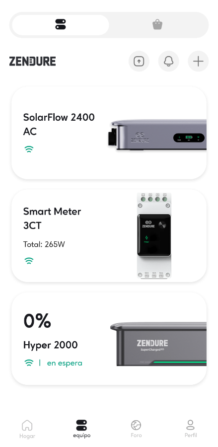

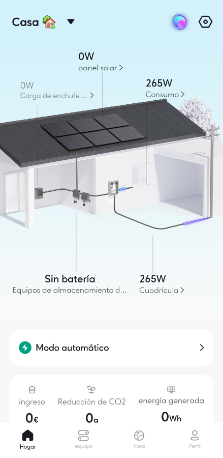

Good news — the Error 49 (Ground Protection & ARM Output Relay Fault) has disappeared on its own. However, the Hyper 2000 is still in standby mode and not supplying any power to the house.
My current setup:
• Hyper 2000 connected to AC grid (grounded Schuko outlet)
• 3x JA Solar 450W panel connected to DC input
• SolarFlow 2400 AC installed and online
• Smart Meter 3CT installed and reading 265W total consumption. Is working in automatic mode.
• AB3000X batteries not yet arrived (they are for the SolarFlow 2400 AC, not the Hyper 2000)
• HEMS enabled
My question is: shouldn't the Hyper 2000 be using the solar energy from the connected panel to supply power to the house, even without batteries? The Smart Meter 3CT is correctly reading 265W of home consumption, so the CT is working fine.
Is standby mode normal without batteries connected? Or should it be actively supplying power from the solar panel to cover home consumption?
