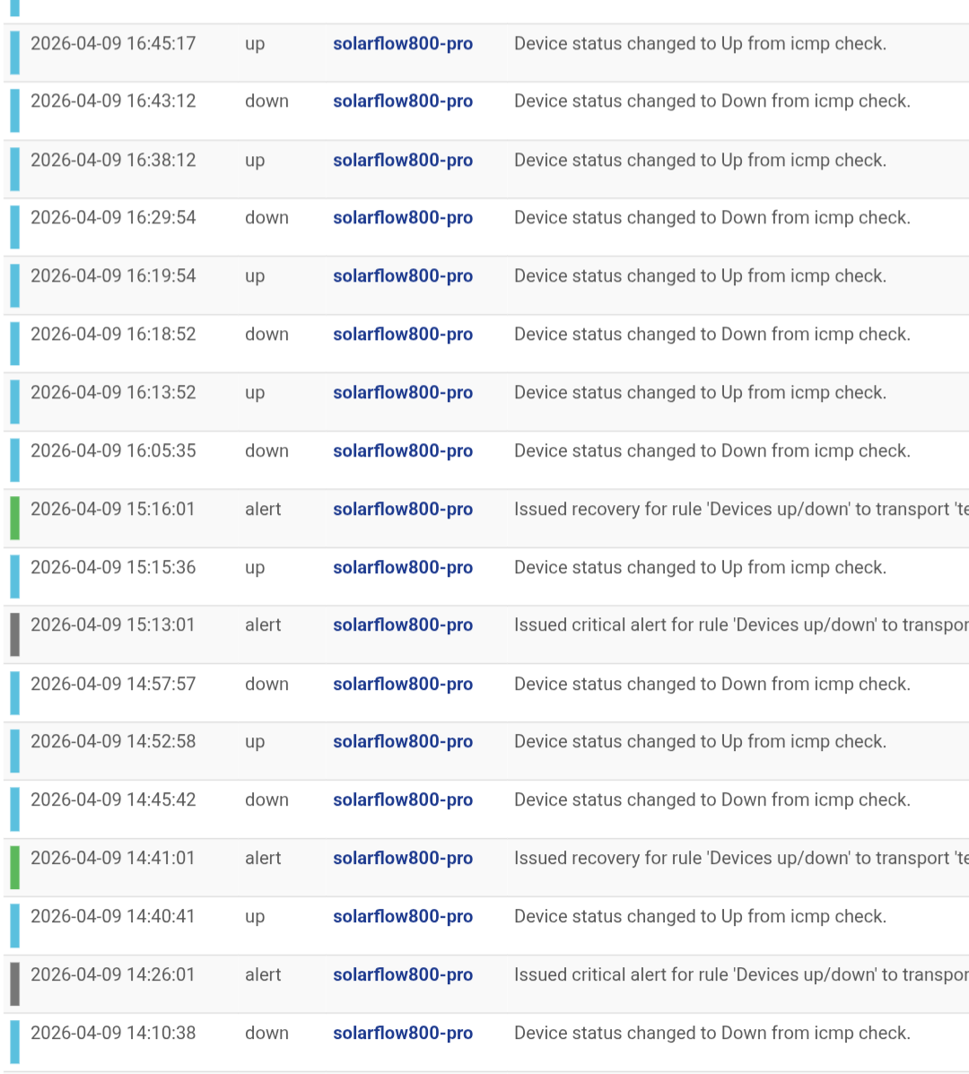

I recently bought a Solarflow 800 pro plus additional battery and it worked fine for a while.
During the last weeks, I registered some disconnects of the solarflow and also other wifi devices during peak hours. Interestingly this only happens on days, when I get around 1 kW power from my panels.
Restarting my wifi ap (eap673) helps for a short time but shortly after the solarflow disconnects again. In the afternoon, when power is lower, it then reconnects and is working fine for the rest of the day.
On all other days (like today), I do not see a single disconnect.
Any ideas, what I can do? Connection is at -61db and as I said rock stable.
The solarflow is connected to a 2.4ghz wifi with WPA2.
Cheers
Alex
This is how librems sees it:
