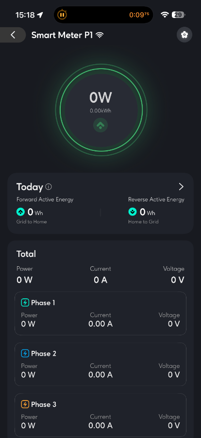

I’m trying to get the Zendure P1 Reader working with an Iskra ME382 smart meter (DSMR 2.2).
Setup:
• Iskra ME382 (DSMR 2.2, P1 active – Liander)
• Zendure P1 Reader powered via USB-C
• Zendure Bridge OK (solid green)
• HomeWizard Active P1 Splitter (HWE-AMP-23) powered via USB-C
• Tested all 3 splitter ports
• Waited >10 minutes per test
Behavior:
• Splitter LEDs blink (P1 IN + output → data is flowing)
• Zendure P1 LED blinks fast green (1 Hz)
• Zendure app stays at 0 W
Zendure support claims compatibility with Iskra ME382 DSMR 2.2, but in practice it doesn’t seem to parse the telegrams.
👉 Has anyone actually made this combination work?
Any firmware tricks or confirmed success stories?
