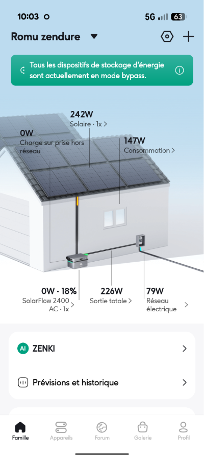

In coordination with Zendure, Zendure confirmed a bug in firmware version 1.0.8 regarding our desribed oberservation here where the "bypass" mode ist not left/skipped once the battery falls below the configured SoC level although the PV power is permanently delivering more power than the demand of the house + 50W.
According to Zendure this bug ist going to be fixed with the next Firmware version provided end of 11/2025.
Dear community, please confirm this is the case.
