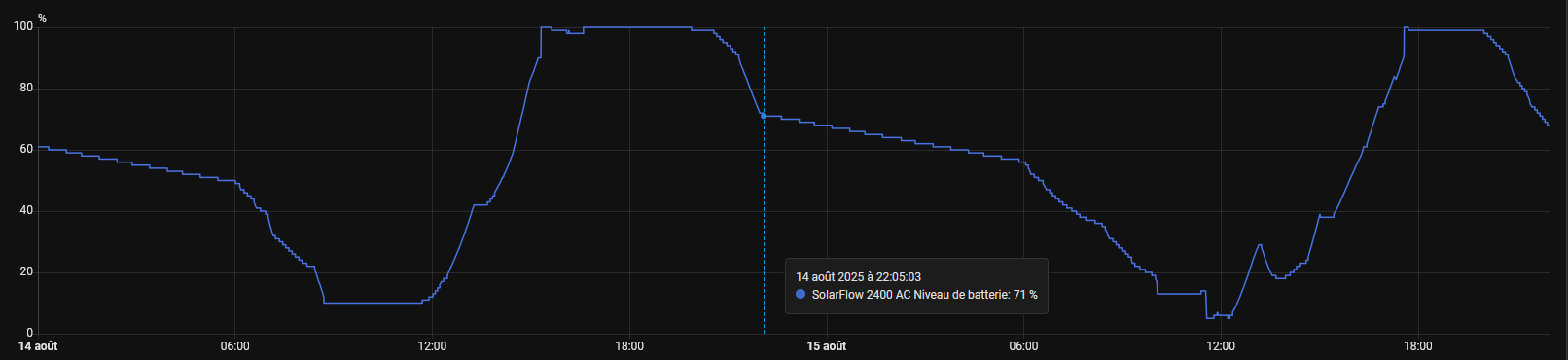

Here is an illustration from yesterday:
Went off at 10PM with 71%, woke up at 6AM at 55%. The SF2400AC was off for 8 hours.
I reproduced with HEMS by cheating and putting a "charging" session from 10PM to 6AM at 0W. The exact same thing happened.
