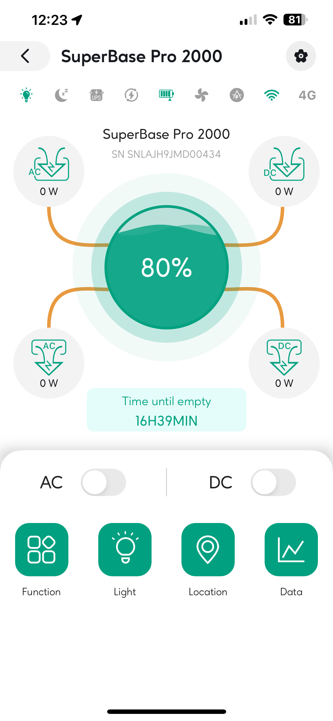

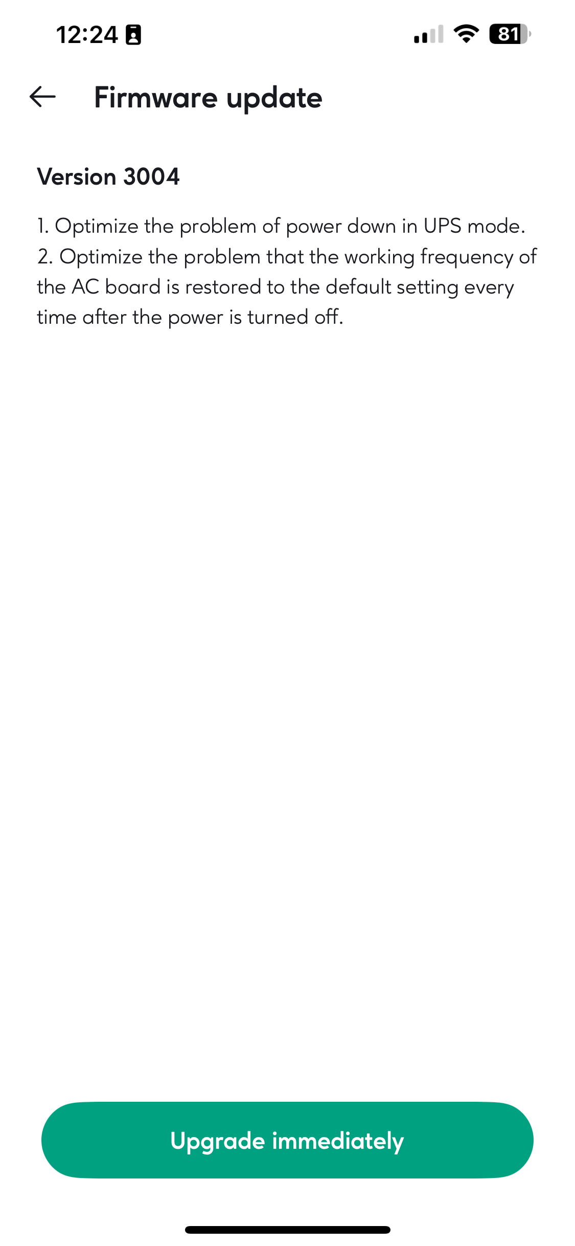

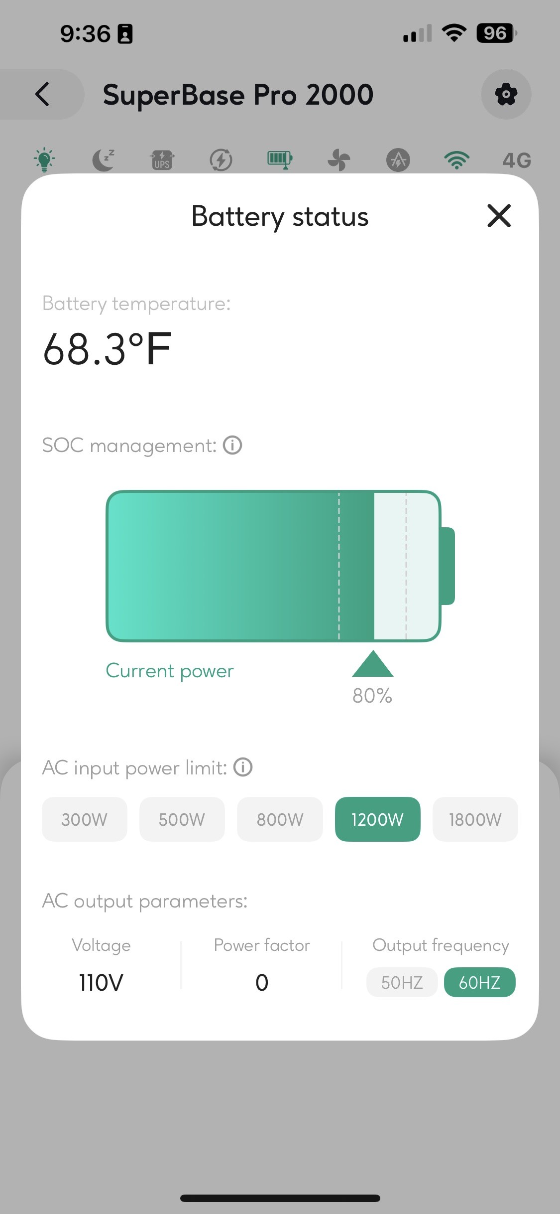

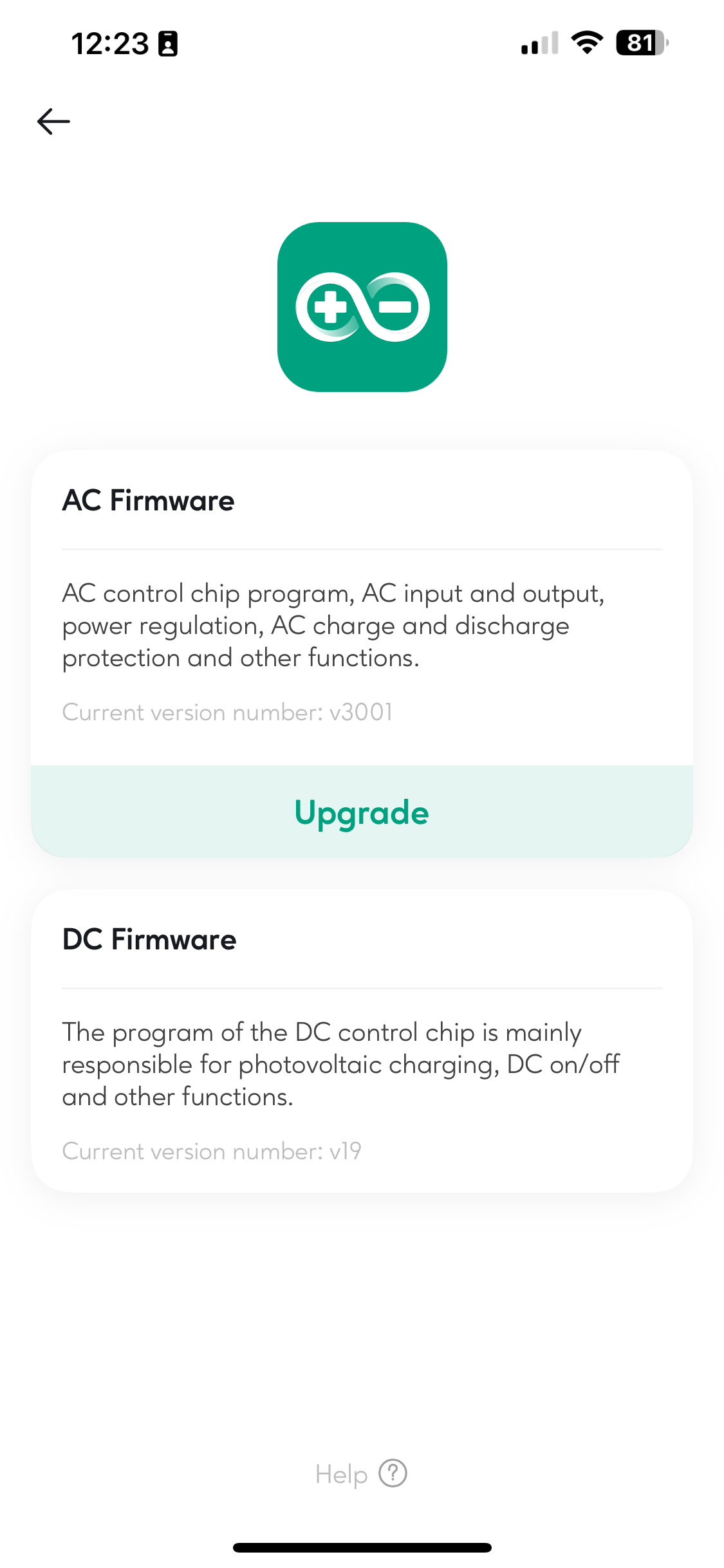

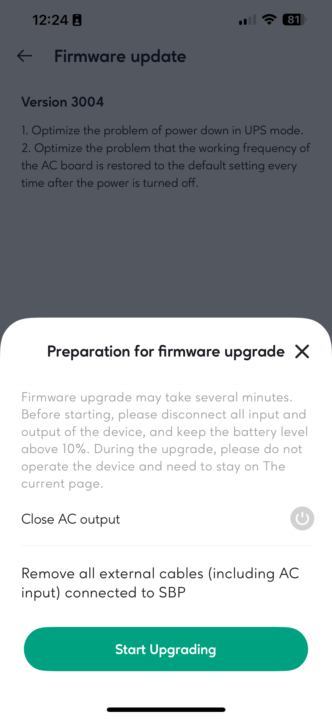

Do I even want to upgrade from v3001 to v3004? So many people posting in the last year about the firmware update messing with their systems. I just turned on the AC so I could use the power in the battery while it's plugged in and it started charging from the 80% I set it to, to 100%. I guess the good thing is that it didn't turn OFF the AC when it got to 100%. It finally got down to putting out around what it was taking in, so I guess it's finally full.
Oddly the smart plug I had it attached to claims it took 1.57kWh today, mostly just to charge my SBP2000 from 80% to 100%. I thought it was just the LFP based units that had trouble tracking the charge level of their battery banks...
