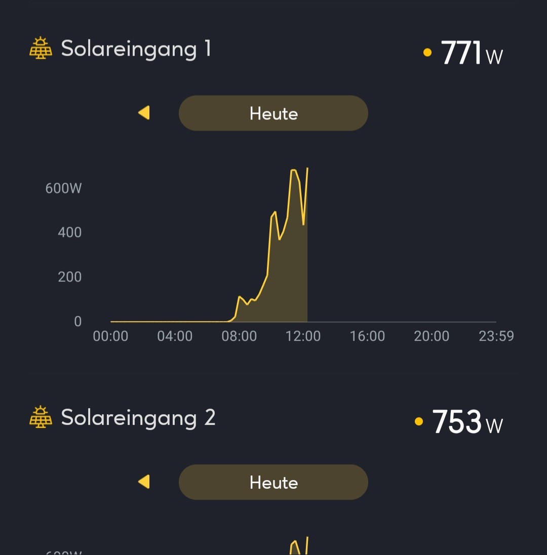

Igor Does anyone know why hub2000 output reaching only 1070W in CT and any other modes? I set max output to 1200W. My microinver is hoymiles hms-2000-4t I opened a ticket on zendure support but after they asked me to proceed with some tests I have not received any response

Igor Jadawin, I was expecting hub2000 to take all power from PV and the rest of power from battery. That should result in 1200W output to home
Peter Bitte berichtigen wenn ich einen Denkfehler habe. Der Hub 2000 hat einen Ausgang der auf die Eingänge des WR verteilt wird. Da dein WR aber 4 Eingänge mit jeweils einem mppt hat gehe ich mal davon aus dass du nur 2 Eingänge belegt hast. Also max. 1000 Watt Input von 2000.
Igor Peter, great call💪🏼. Indeed Hub distributes only to 2 of 4 inputs of inverter. Thanks for the suggestion. I'll try to distribute to the rest of inputs. I'm still wondering why it didn't reach 1200 W 😉 but 1070 W (max in my case)
Igor Thanks Peter! Good guess 💪🏼. Indeed Hub distributes only to 2 of 4 inputs of inverter. Thanks for the suggestion. I'll try to distribute to the rest of inputs. I'm still wondering why it didn't reach 1200 W 😉 but 1070 W (max in my case)
Igor I finally rewired panels and indeed HUB power output is 1200W - device maximum I had to connect hub outputs to more then 2 inputs of microinverter even if microinverter supports 650W+ per input port
