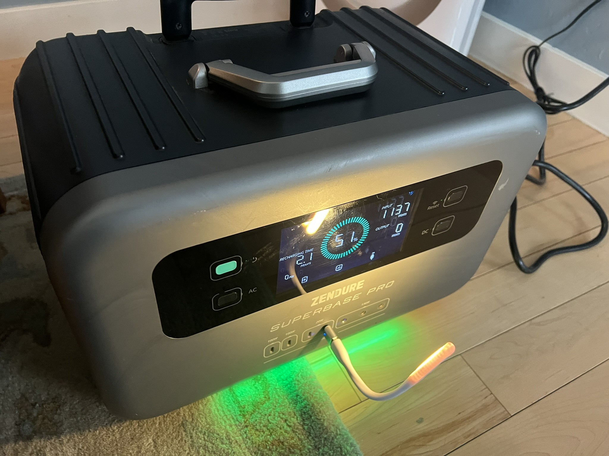

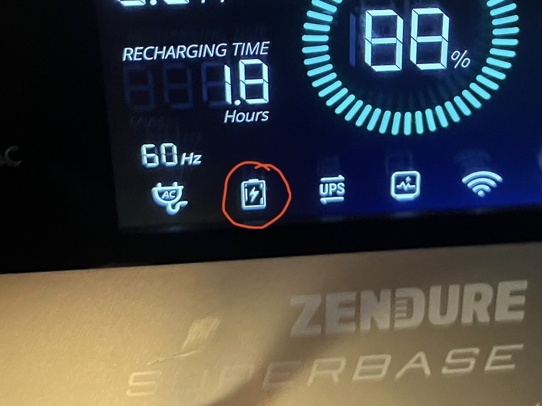

I opened a ticket with Zendure when I purchased this unit and found it would not charge from the wall. Their A.I. suggested that I leave it charging for many hours to be sure it won't do it. If that didn't work to hook up via the XT60 plug next to the AC inlet and charge that way. I hooked up my Superbase 1000M to it and it again looked like it was charging but showed 0% and 0:00 until finished charging. I also did the DC charging for a day. I wrote them again with the results but haven't heard back.

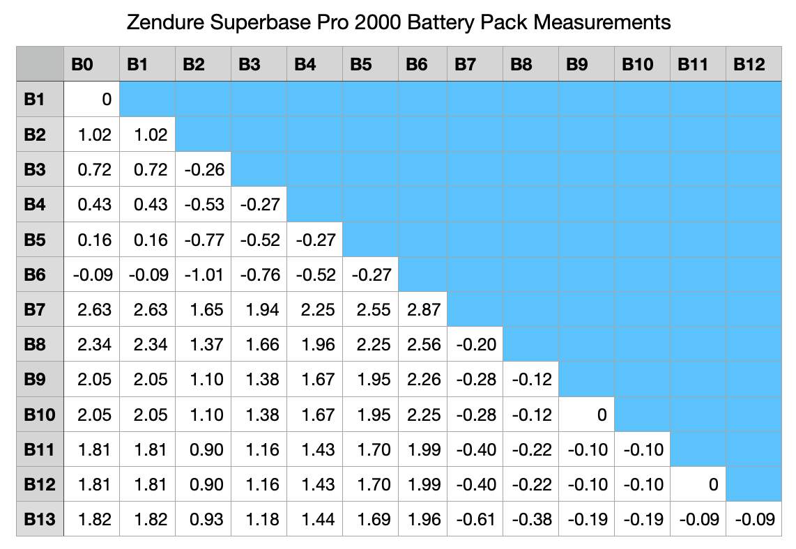

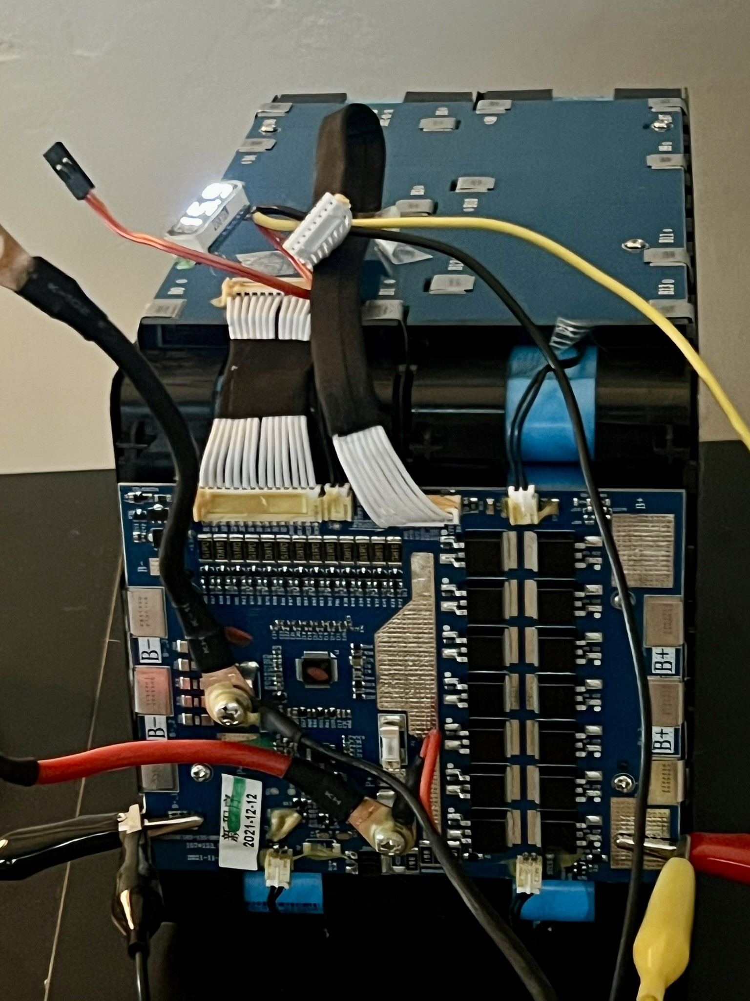

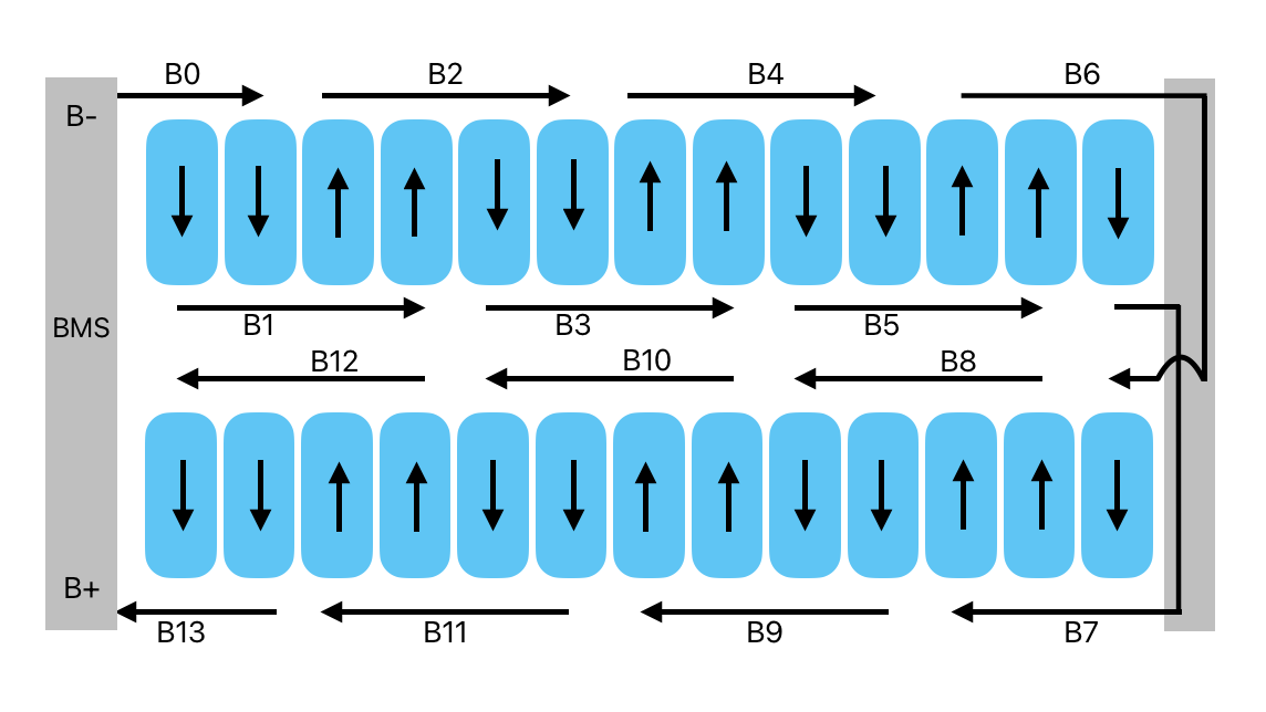

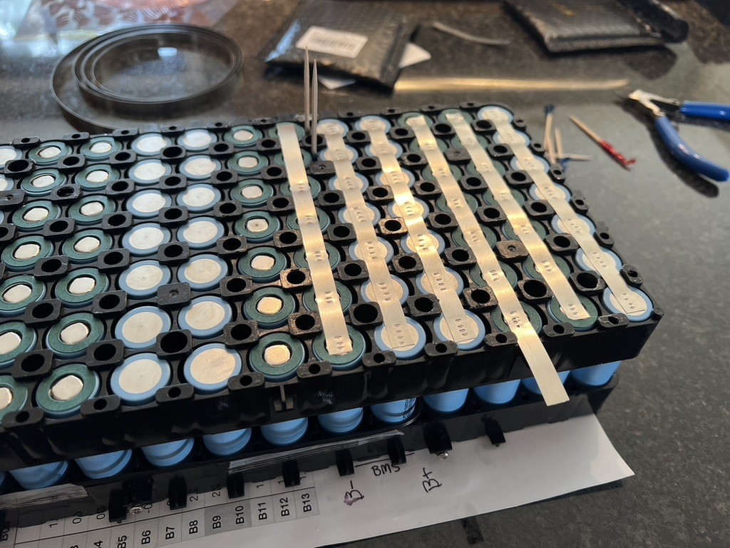

I spent the day taking the Superbase Pro 2000 apart, and I now have the battery pack with BMS and parallel boards out and I am measuring only 1.8 volts. That's TOO low for a pack of this size although I'm not really sure what the normal voltage should be, probably 48v. To see if I can bring the battery back to life I have hooked a fifteen volt one amp power brick to the battery B+ and B- which I will watch for the next day or so. Anyone has any better ideas?
I have a Drone charger but it only has 7 pins to connect to each row of parallel batteries. This pack is 13s14p, I don't have anything that can intelligently charge it, so I will try to get the voltage across the pack high enough to wake the BMS up so I can finish charging using it.
I did connect to it via WiFi while Iit was trying to charge and looked at its history. Apparently it was used only once, in July of '22, it was charged all the way up and then a few days later discharged and hasn't been touched since. That kinda makes sense, the BMS board shows a production date of 12/12/21
