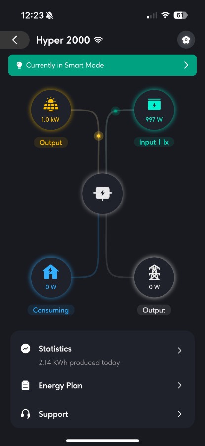

I got 3 500wc panel on a Deye pushing watts in my grid
And a Hyper2000 with 3x500Wc panels plugged.

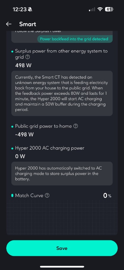

It works like a charm but this morning the hyper for no reason doesn’t want to keep the surplus.
The Shelly detect it well and made him switch into AC mode but the curve stay at 0
Any idea ? Solutions ? All update are done
